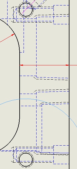

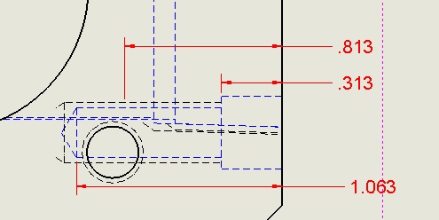

Hole Thread not showing properly on Detail Drawing
When using the hole wizard to insert tapered thread feature and a thread with counter-bore, the cosmetic thread is not showing properly. How can this be fixed? The drill depth and thread depth are not "overlapped" in the feature settings and set to default size settings.  Also you can see a regular tap's thread is showing fine.
Solidworks 2017 SP1.0
