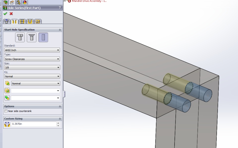

- First Part Settings

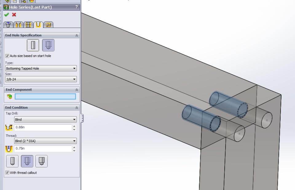

- Last Part Settings (After creation. Note the blank end component, but it still created the holes.)

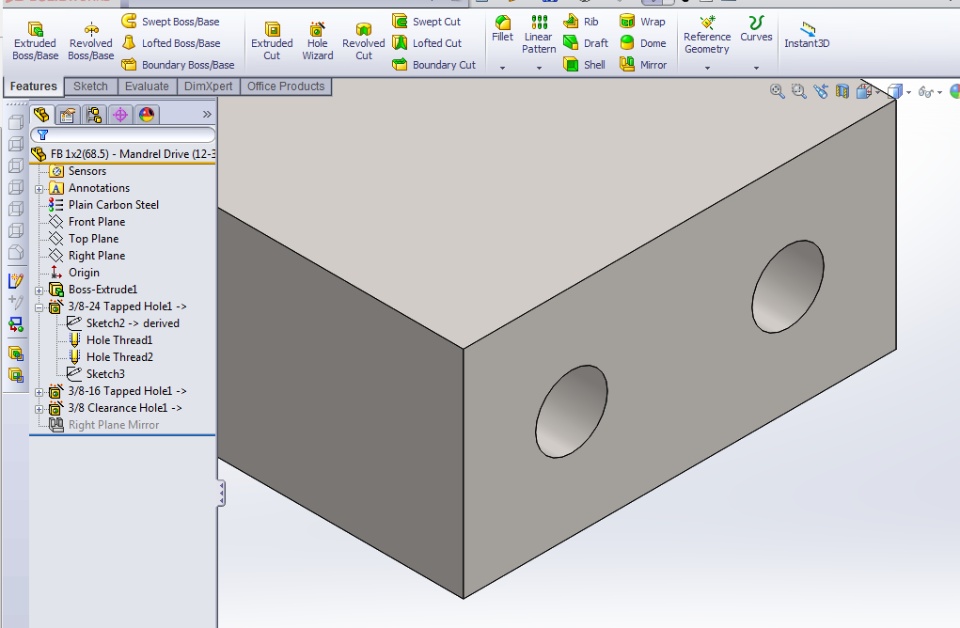

- Feature tree from "Last Part" (Note the threads aren't shown on the part.)
