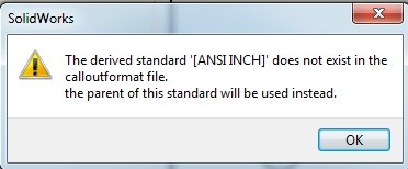

If I create a metric hole, add the note with a depth tolerance, then change the hole to be inch-based, when I edit the hole callout I get an error that says:
"The derived standard '[ANSI INCH]' does not exist in the calloutformat file. the parent of this standard will be used instead."
How do I correct this so we can add depth tolerances for inch-based holes?
