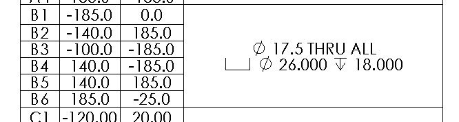

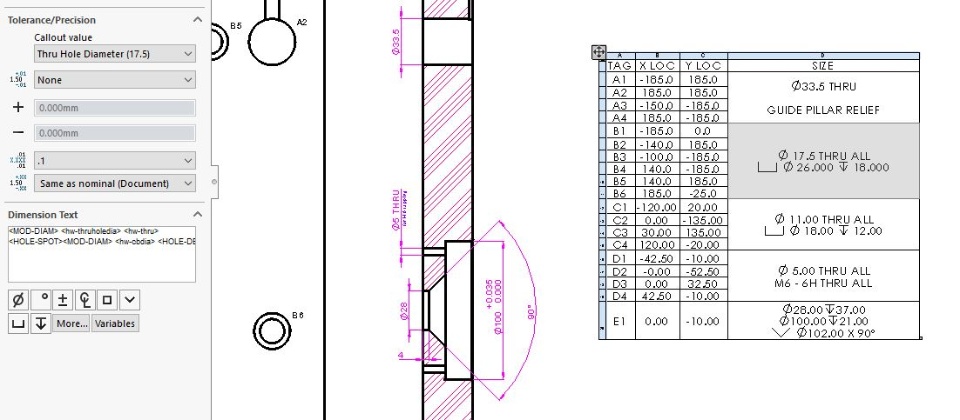

I would like to know is there any way to set the precision to our choice for the hole call out created on the hole table. Attaching the screen shot of my hole table. When we do the detailing of the counter bore the diameter and depth value is getting with 3 digit precision which I would like to alter. At present I will edit this manually on the property manager. But this takes lot of time.. Need some support..
