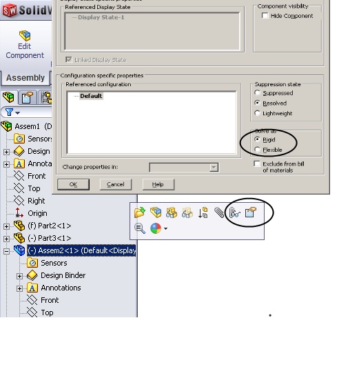

I am working on an assembly that has a hinged panel; i constrained the hinge as a hinge, so I set an angle for opening and it works fine as standalone assembly; however, in my larger assembly I can only open the panel by opening and closing the hinge independently; i.e., setting the hinge at an angle will set the panel in the assembly at that angle.
Is it a way I can open the panel directly in the assembly without having the hinge open in a separate window?
