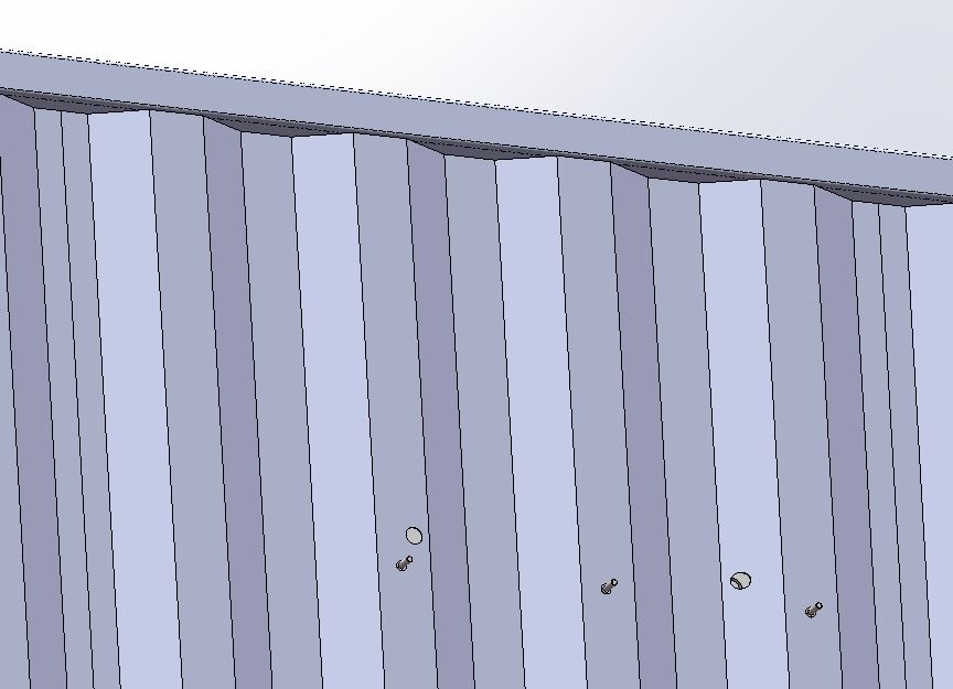

Model image:

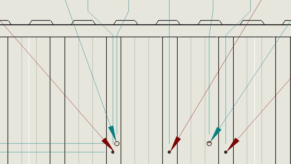

I had pretty good results with assigning the recessed edges to be light grey (as long as its saved PDF is set to [x] Export PDF in Color). One remaining issue, however, was a panel edge, where one panel ends and is seamed with the next panel. This detail is mostly irrelevant in our use, and furthermore unreliable from a standard download which I did not design from "product in hand". So, I wanted to Hide specific selected Edges in the Drawing. I could not find a way to do this directly.
Drawing image:

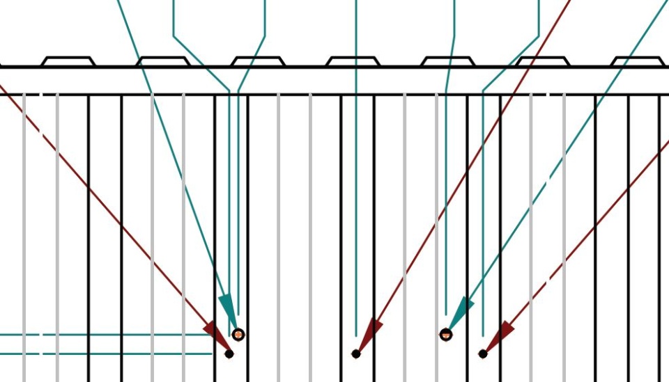

What I did which did work acceptably, is to select the seam and set its Line Color to White. Then, after exporting the PDF in color, the line is present as white on white, and then does not produce any line when printed for shop production. It does retain a minor artifact of the line, as its endpoints slightly overlap the horizontal edges at its top and bottom. As such, it is not purely hidden, but for the most part it does not show. But then, when gathering some screenshots to attach here, I noticed that every edge like with color override appears (in PDF only) ON TOP of the dimension and balloon leader lines. In this way, they appear "dashed" in the PDF output. I also tried adding a new dimension to it, thinking that the last modified item is 'on top', but the new dimension was partially obscured with the edge line that were colored just the same as the entities which existed before I changed edge colors. This leads me to an awkward series of questions as I try to make it appear better:
PDF export image:
