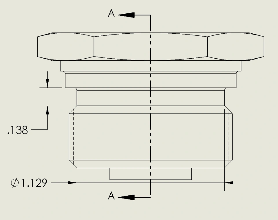

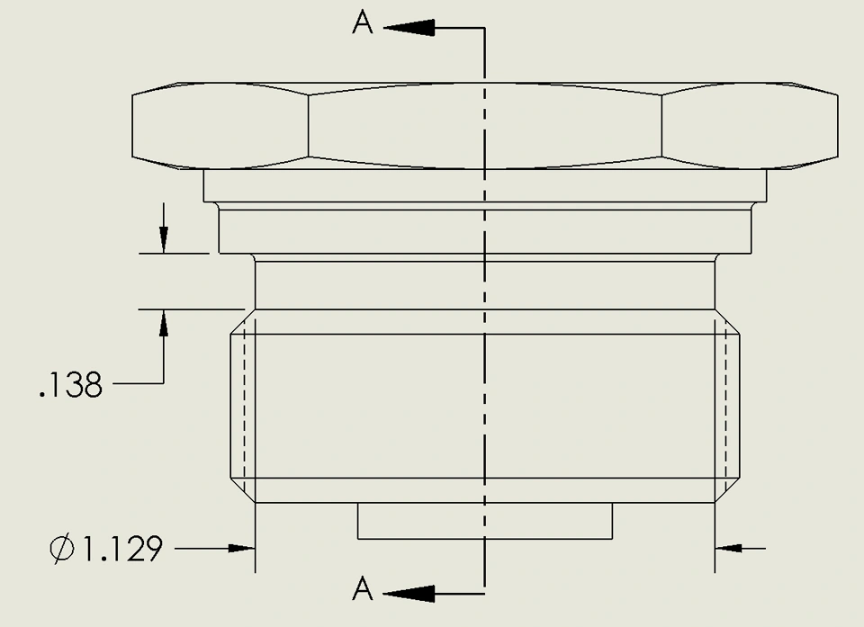

When I hide an extension line, it draws a line across the dimension that wasn't there before. My drafting standard is ANSI, and the toggle "Remove dimension lines for outside arrows" does not seem to make a difference.
This only seems to happen for linear diameter dimensions. In my example below, the .138 dimension hides the extension line exactly as I'd expect, while the DIA 1.129 shows the line that appears across the dimension.
Is anyone else having the same issue?
Before:
After:
