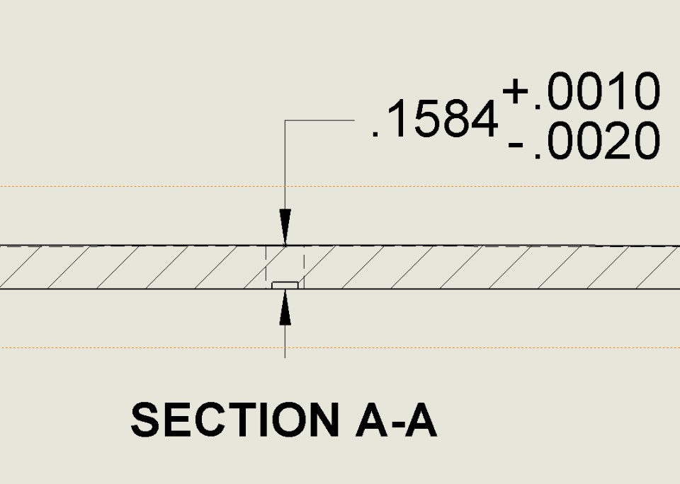

Is there a tick box somewhere that I'm missing to turn off hidden lines within Section Views? I know they can be turned off by changing the display style but I'd rather they not be there to begin with.
Backstory: We've recently updated to SW2017 SP2. I had a number of issues that were resolved through deleting my registry and not pulling the "Copy Settings Wizard" through to the new install. I've never had hidden lines in my section views before and don't want them now but can't find where to turn them off. (Since when is that something that is OK to do anyhow? Section Views with hidden lines ... That's just not right IMHO)
