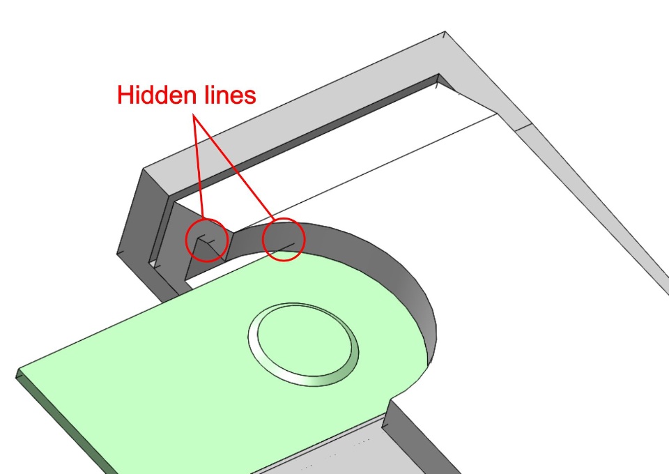

This issue started yesterday with a multi-body part: hidden edges are showing through solid parts. I've attached some screenshots.
It's not exactly like the 'bleed through' problem that happens with thin sheet metal parts, but it's similar. The main difference is that it mostly just happens at the corners of the components or where one component goes behind another. And this is happening in part files, not drawings.
