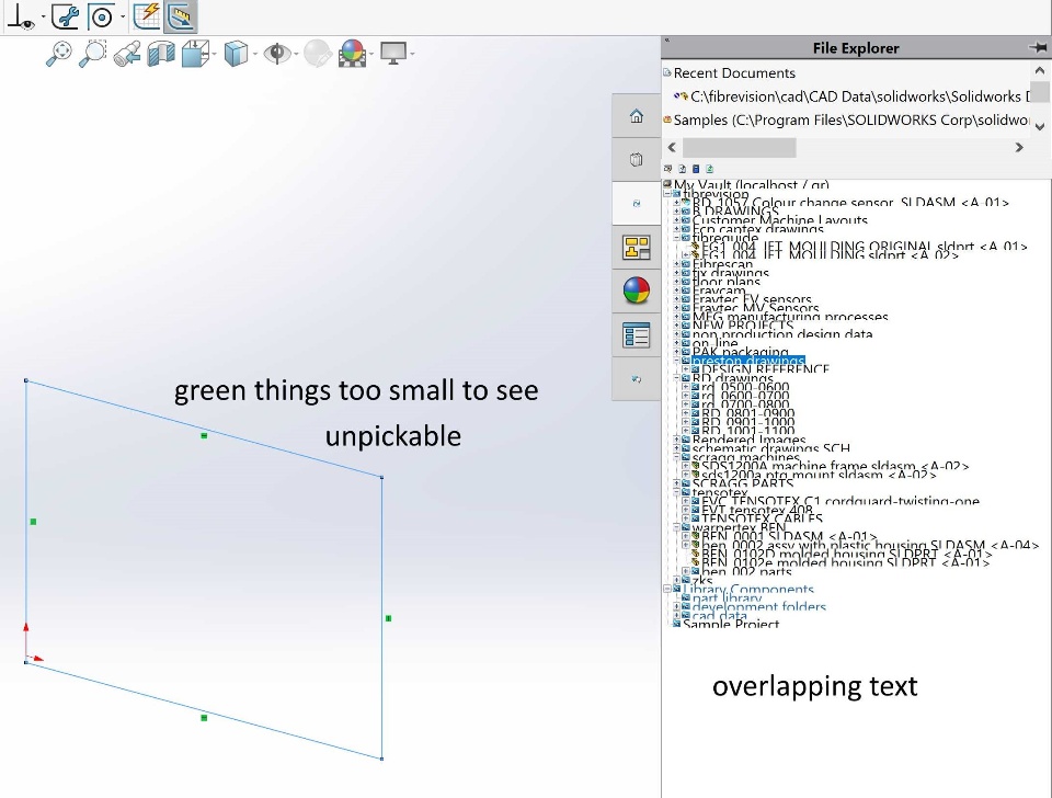

Like many I am struggling with getting SW2016 to be usable on my 15.6" screen at its native resolution, despite claims that SW2016 is fully scale-able, as soon as I opened it I see that it is not as described and not fit for purpose.
Lots of issues are listed in various forums, but nobody seems to have reported my issue of overlapping text in the file explorer window, which is where I access all my data from the Workgroup PDM vault. Its pretty much unuseable.

Anyone else see this issue? is it only vault users who use this file explorer window?
My laptop: Dell precision 5510 with M1000M and 15.6" at 3840x2160 using the approved driver freshly downloaded from SW website, the first time I have ever had a system with the exact model listed as approved, passing all tests without issue! - yeh, right...
I haven't even got as far as extruding any geometry, its a very disappointing experience.
scaling is at 250% here (recommended). The text overlap is almost gone at 150% but that is far too small. The text stops being legible at about 175%, too small to read easily. If this particular text was not scaled at all I'd use the magnifier and the software would be use-able, but this scaling of text but not line spacing is rather disastrous and I dint find any sort of solution yet.
