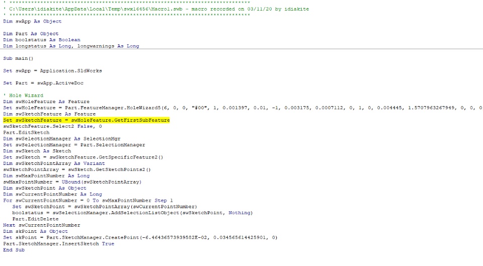

Dim swApp As Object
Dim Part As Object
Dim boolstatus As Boolean
Dim longstatus As Long, longwarnings As Long
Sub main()
Set Part = swApp.ActiveDoc
' Hole Wizard
Dim swHoleFeature As Feature
Set swHoleFeature = Part.FeatureManager.HoleWizard5(6, 0, 0, "#00", 1, 0.001397, 0.01, -1, 0.003175, 0.0007112, 0, 1, 0, 0.004445, 1.5707963267949, 0, 0, 0, 0, True, "", False, True, True, True, True, False)
Dim swSketchFeature As Feature
Set swSketchFeature = swHoleFeature.GetFirstSubFeature
swSketchFeature.Select2 False, 0
Part.EditSketch
Dim swSelectionManager As SelectionMgr
Set swSelectionManager = Part.SelectionManager
Dim swSketch As Sketch
Set swSketch = swSketchFeature.GetSpecificFeature2()
Dim swSketchPointArray As Variant
swSketchPointArray = swSketch.GetSketchPoints2()
Dim swMaxPointNumber As Long
swMaxPointNumber = UBound(swSketchPointArray)
Dim swSketchPoint As Object
Dim swCurrentPointNumber As Long
For swCurrentPointNumber = 0 To swMaxPointNumber Step 1
Set swSketchPoint = swSketchPointArray(swCurrentPointNumber)
boolstatus = swSelectionManager.AddSelectionListObject(swSketchPoint, Nothing)
Part.EditDelete
Next swCurrentPointNumber
Dim skPoint As Object
Set skPoint = Part.SketchManager.CreatePoint(-6.46436573939582E-02, 0.034565614425901, 0)
Part.SketchManager.InsertSketch True
End Sub
