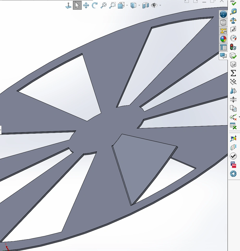

I'm fairly new to SolidWorks and using it for university, but have some Fusion360 experience. I need someone to point me in the right direction or let me know if what I'm trying to achieve is possible.

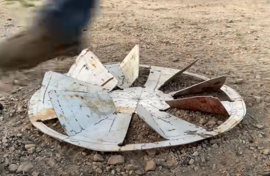

I want to model the following sheet metal part (as seen in the screenshot), but I cannot figure out how to achieve the bent fins. I have a sketch with a circular pattern, and have tried first cutting them out, creating an offset inner "fin" but haven't been able to make this bend. I semi-achieved it by creating a separate body, then rotating and lofting it to the main body (2nd screenshot), but obviously, this is bad practice and also extremely tedious. Ideally, I need to be able to circular pattern the bent fins
I'm not sure if what I'm attempting is actually possible in SolidWorks, so any advice is appreciated.
