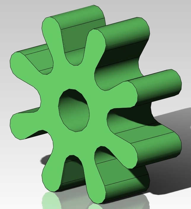

I'm trying to "cut" a spur gear to match the profile of the pinion gear I designed. This gear won't carry any load, it's basically for esthetics, but I want good contact between the two gears.
I have an 8 tooth pinion & 60 tooth spur gear.
(Attached below: Untitled)
Here is my pinion gear:

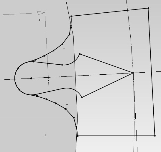

I am working with one tooth profile and trying to simulate it moving out of the mating gear. Seems simple enough...
This is the shape of one tooth, and the line/arc segments are something I drew that approximates what I should end up with (I used the assembly and adjusted the points until it was close).
(Attached below: Untitled_1)
I could just use those line segments, but I really want to figure this out mathematically.

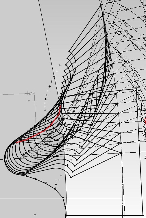

I'm sure I’m over simplifying this because here is my result:
(Attached below: Untitled_2)
The red line is the line/arc that represents where I should be.
I know it's really cluttered, but I figure once I get this figured out I can just use this file as a template.
So obliviously .66666667 is too much of an increment.

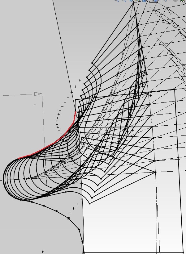

Just playing with the numbers I found .59 is really close to what I need. But I don't know how to get there mathematically.
(Attached below: Untitled_3)
Does anyone know if I'm just completely over simplifying this, or am I doing something wrong in the math????
