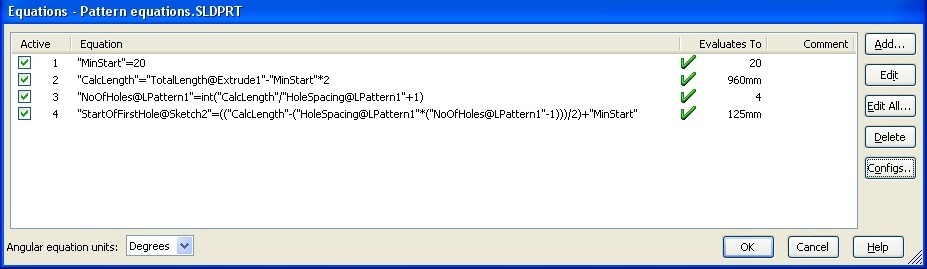

I have a part with a linear pattern of an ideal pitch of 250mm and I want to control the number of instances and the "y" dim of the first hole usilng an equation if possible.
any help would be appreciated
