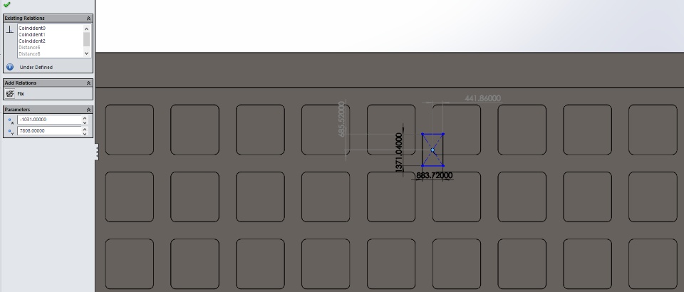

I was trying to implement a Macro which selects a surface on a cube and draw rectangles on it using the CreateCenterRectangle method. The units i was using is Microns (code below). The code works, However, it is not drawing the center of rectangle at the right position. If you look at the code below the center is -1089.14 , 7993.52. However on actual rectangle it is way off (see the screenshot). I am not sure why is that happening or what could be done to correct it.
Any help or suggestions are welcome.

  vSkLines = swSketchMgr.CreateCenterRectangle((-1089.14 / 1000000), (7993.52 / 1000000), 0, ((-1089.14 + 500) / 1000000), ((7993.52 + 500) / 1000000), 0)
Actual Rectangle screenshot:
