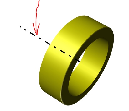

Path Line Properties I'm trying to change:
  • Disable "Stay on top"
  • Front Line / Symbol Size (2) & Space between symbols (.25) & Extremity / Size (.5)
    • The first two do not appear to be editable, unless "Type" is changed to "Advanced", a dash is selected in "Symbol#1" and then "Symbol size" appears in properties. "Advanced" does not allow long dash, short dash. Instead, advanced only allows short dash. I wanted to keep long dash, short dash like the default, but am forced to sacrifice this if I want to change the size.

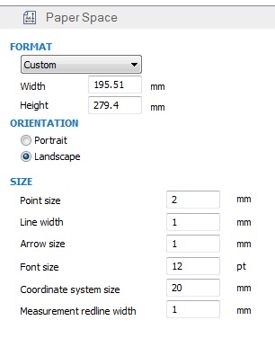

I'm exporting high resolution images to alpha channel *.png (background removed) @ w3.82" x h2.68" (w97.28mm x h68.07mm) to import into Microsoft Word for use in a work instruction. In order to maintain a working aspect ratio on my paper size, I've set the paper size to w195.51 x h279.4 Landscape (7.69in x 11in).
The Size options under paper size, don't appear to change the Symbol Size, but do change the Extremity size (per "Point Size")
