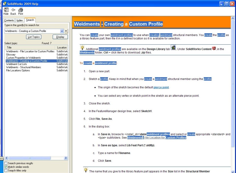

I have followed the 5 steps in SW help for ‘Weldment - Creating custom Profiles.’

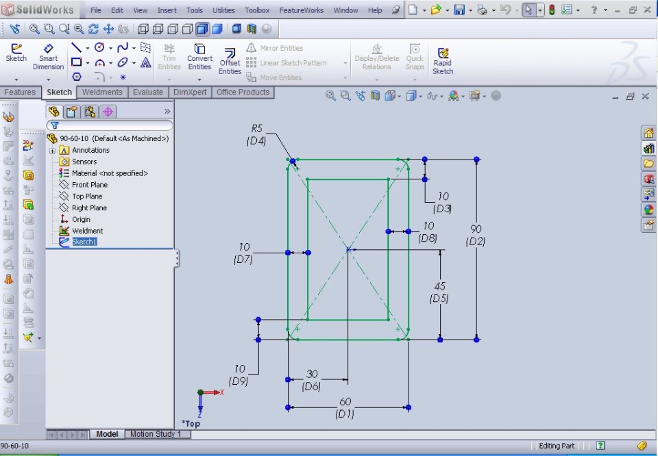

What am I doing wrong? I have included the profile of the rectangle I am trying to make and the help from SW help. It is a fully defined sketch.
