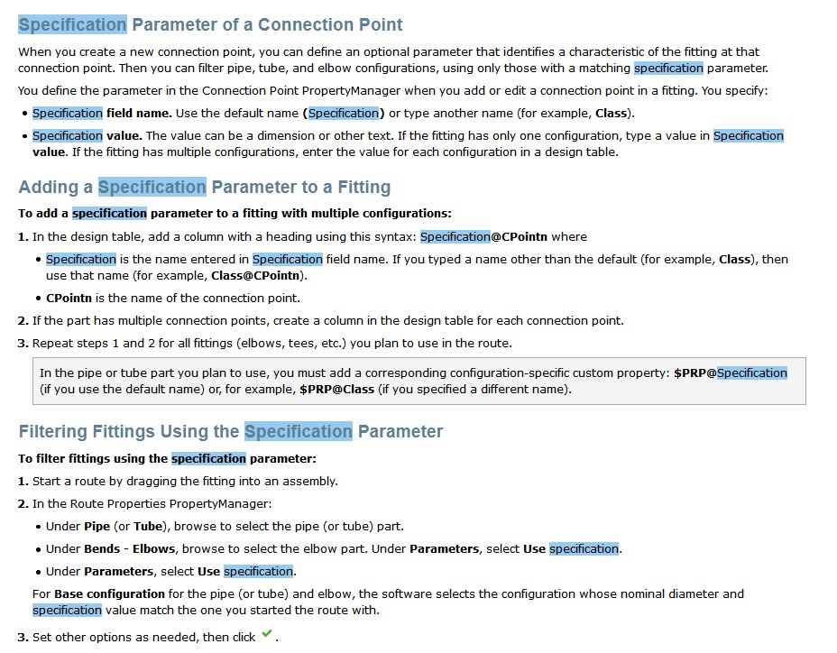

this in 2012 help files gives you this
Not great. Not much detail but at least it hints to some things.

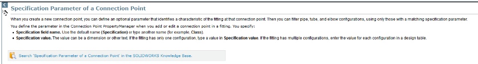

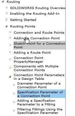

However, in the 2018 version, on the same branch
it's reduced to

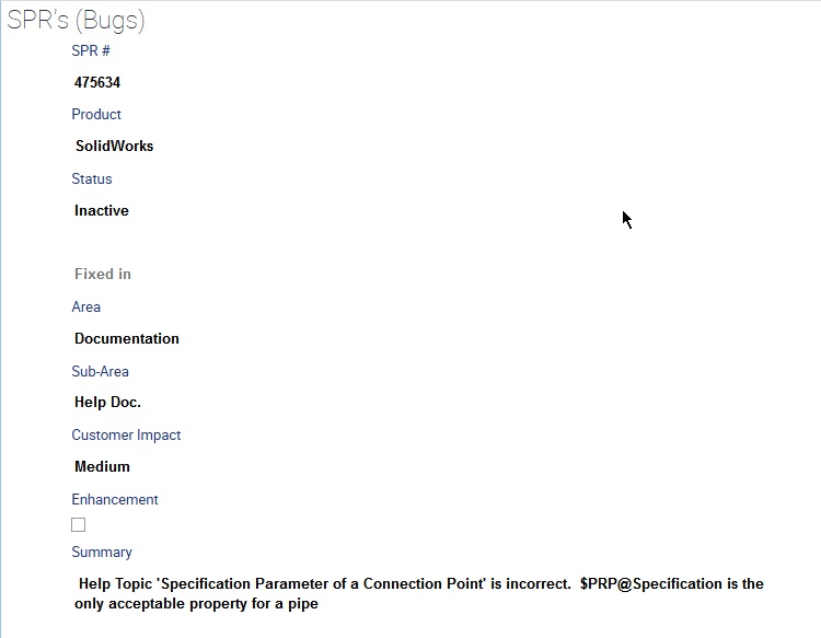

On top of it comes the fact that if you click on the link about the subject that takes you to the knowledge base you get send to an SPR
which, as you can see, shows you that there used to be incorrect information.
Or in other words that a bit of info on the 2012 was wrong. (see the 2012 info that I captured). But instead of correcting the error they just wiped out the majority of what already was a very limited bit of information. They didn't even do so on the 2012 page so anyone visiting the 2012 page doesn't know there's an error in it unless they bother clicking the link.

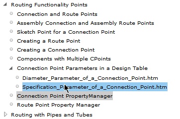

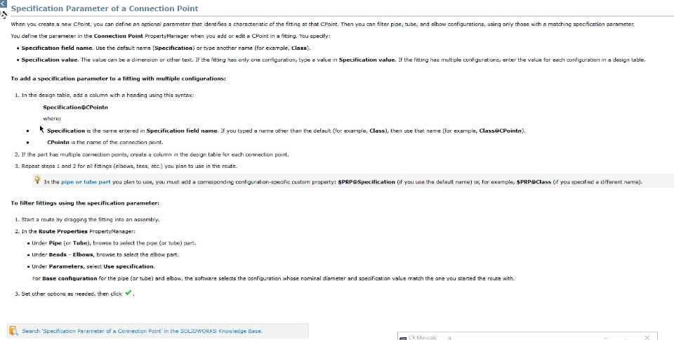

Oh but what about 2020 version?
In other words the same info as 2012 but with a bit different layout and appearence. Which also means that if 2012 had wrong info then 2020 has wrong info too!
