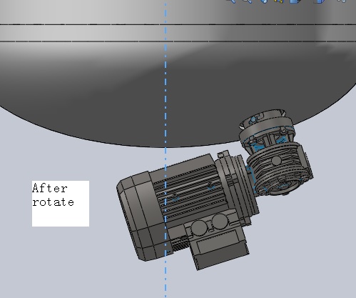

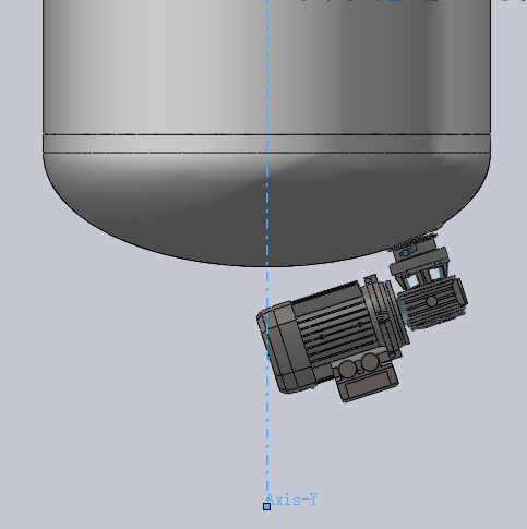

like the bellow pic. this is assembly file. if I want to let the "motor" rotate about axis_y certain angle,
what' s  the best way?
I used to use mate, this method can achieve the purpose, But I have to pre-defined axis and the plane for  part,This is too much trouble
Then I use dragoperator, this method has a big problem, afterI drag, I can't read the data how much angle the part rotate about the axis.
SO I use mathtransforms. through this method, I can easily calculate X,Y,Z cooridinate value after the part rotate about the axis certain angle.
the only puzzle is :how to calculate another date. like bellow.

'the puzzle is how to calculate value A,B,C after the part rotate around the axis_y 30 degree(for example)
     arr(9) = X:    arr(10) = Y:  arr(11) = Z
'9 to 11 represent X,Y,Z after the part rotate about axis
        arr(12) = 1#
      ' No used so pad with zeros
    arr(13) = 0:   arr(14) = 0:   arr(15) = 0
vXform1 = arr
    Set swXform = swMathUtil.CreateTransform(vXform1)   ' create unit transform
        swComp.Transform2 = swXform
can you tell me how to calculate value arr(1) to arr(8) ,after the part rotate 30° about AXIS_Y for example?
