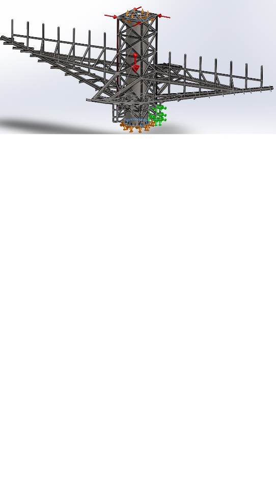

Hello, Im working in a structural problem in a tailings thickener (50 meter dia).
Central solid column has interferences with central cage (structural members). To avoid contact betweem them there are some PTFA (teflon) support. I´m trying to simulate contact them but I dont have success.
Center column is meshing like a shell
teflon like a solid
central cage like a solidbody
I have used no penetration contact set between teflon and central column.
Any suggesting??
Thanks
SolidworksSimulation
