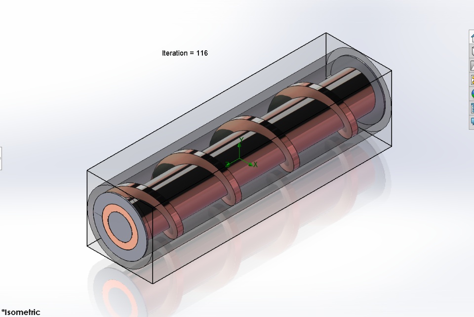

First off, this is probably some rookie mistake as I am a student making this for a school assignment. The assignment requires me to model a counterflow tube-in-shell heat exchanger, and to experiment with different ways to make the heat exchanger more efficiënt. I modeled a heat exchanger constisting of an outer shell and a copper inner tube with a helical fin surrounding it:
I am trying to simulate the temperature of the fluids, i have set up the general settings as follows:
Analasys type: Internal, exclude cavities without flow conditions, and only heat conduction in solids are marked
  • Fluids: only water, laminar and turbulent flow with no cavitation
  • Solids: default solid is insulator (for the outer tube).
  • Wall conditions: adiabatic, 0 roughness. (default settings)
  • Initial conditions: default settings.
In my input data I did the following:
  • Set the solid material of the inner tube (and helix) to copper.
  • Set the inlet velocity of the outer flow (around the helix) to 0.07m/s with a temperature of 80C.
  • Set the inlet velocity of the inner flow (in the copper tube) to 0.05m/s with a temperature of 6C.
  • Set both of the outlets to have environmental pressure.
  • Set a global goal for the fluids and solids temperature (min, max and bulk av).
  • No changes in the mesh.
When I run the simulation, it does simulate the pressure and velocity correctly but the temperatures dont change, thus there being no heat exchanged between the two flows:
My guess is that it has something to do with the parameters regarding the copper solid, but I don't know what exactly.
If anyone could help me out, it would be much appreciated .
(I'm not a native English speaker so my English might be a bit wrong sometimes, if anything is unclear, I apologise)
SolidworksFlow Simulation

Hi Yari,
It looks like you’ve put solid effort into the model—nicely done for a student project! From your description, the issue likely stems from the thermal contact settings between the solids and the fluids. In SolidWorks Flow Simulation, you need to ensure that the "Fluid-Solid Interface" is correctly defined so heat transfer occurs between the copper tube and the fluid domains.
Here are a few things to double-check:
  • Make sure there are no gaps between the fluid and solid bodies—any tiny separation can prevent heat exchange.
  • Confirm that the solid materials are properly assigned, especially copper (not left as default or insulator).
  • Under boundary conditions, ensure there’s no setting that prevents conduction or convection across the interfaces.
Also, consider refining the mesh near the fluid-solid boundaries to capture temperature gradients better.
