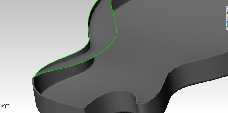

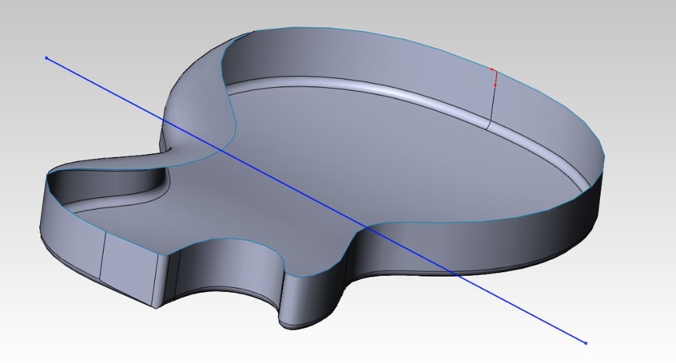

I am trying to model an electric guitar body.
I have the entire body drawn in surfaces (i can knit and make it solid)
but i don't want a solid body, instead i want a body that is roughly 3mm thick.
I have attatched 2 pictures trying to show what i am working with.  The line i have drawn in the zoomed-out picture shows about where the section view is for the other picture.
I had the solid body of the guitar all nicely done, but deleted he back face in order to get inside and thicken the walls
All of the edges are nicely rounded. There are no sharp corners anywhere.  I think that the problem is with the piece that overhanges (upper left side of the section view).
When i click "thicken" the preview shows up very nicely but i always get the, "unable to thicken surface" errror.

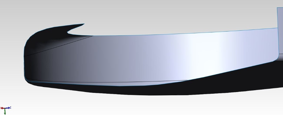

Even if i don't delete the back face and try to shell the solid body i get a strange problem as seen in the third picture.
After getting the error that says something about minimum curvature is too small, the shell procedes to work fine, except for that overhange part.  And you can see that the two green lines remainded surfaces while the rest was shelled.
and the outer green line is a part of a face i had deleted eariler in order to loft that curver overhange section.  For whatever reason the shell makes it come back.
