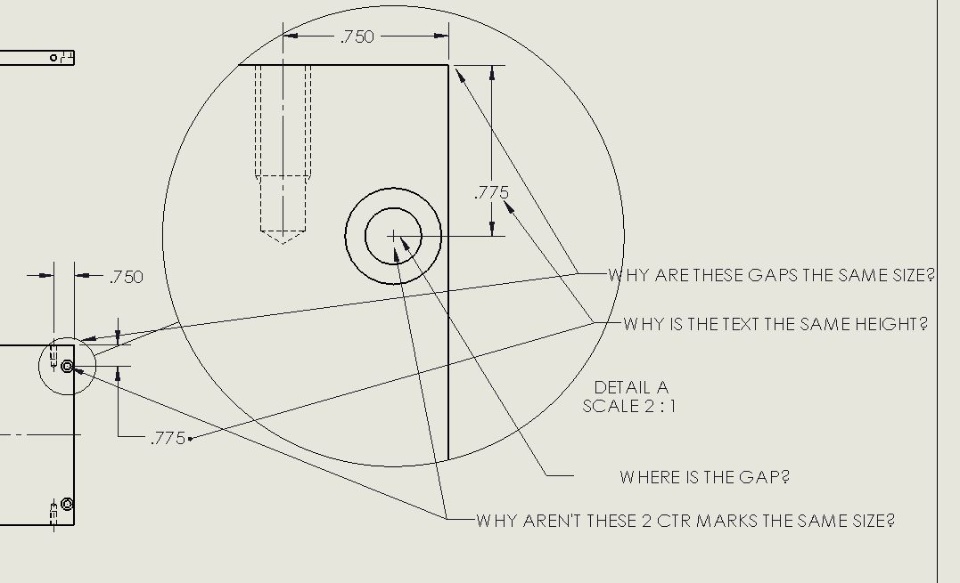

Has SW 2015 or 2016 done anything with Center marks?
Just looking for a reason to upgrade to a newer version. This would would help. Has anything been done to keep the center mark size relevent to the paper size and NOT the model size/scale? Every other option (gaps, extensions, text height, etc,) seems to work correctly. See attachment. I'm not looking for answers to the questions on the attachment, I am just trying to show why center marks should work like everything else.
