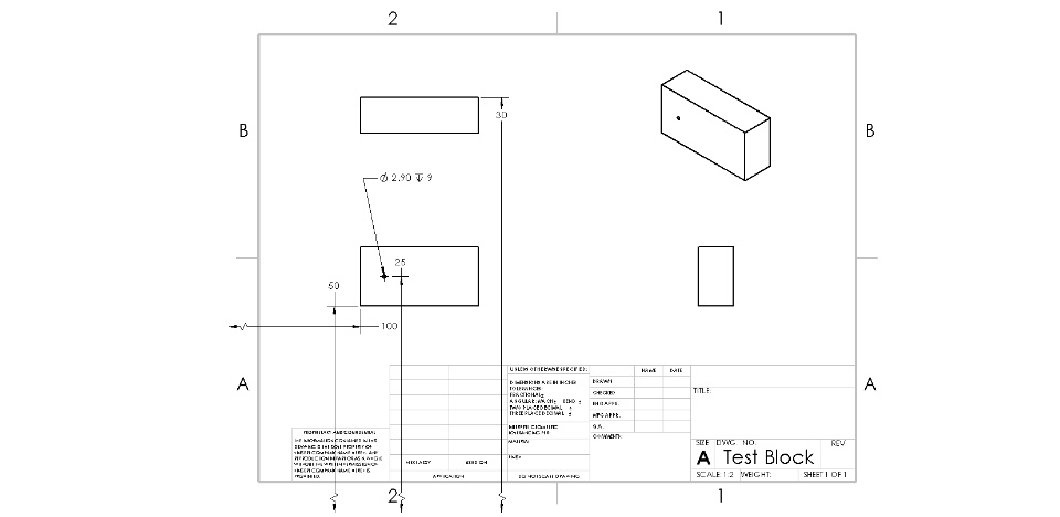

Has anyone had drawing dimensions show as foreshortened and attached to the edge of the paper?
I've tried creating drawings of several different parts, using several different templates and it does this every time. I insert model items and they attach as foreshortened to the edge of the paper. They act correct as far as being driving dimensions, if I change them, they update the model correctly. I just can't figure out why they are showing up this way. I've sent the files to SolidWorks to test, just wondering if I'm the only one experiencing this. If so, I'd love to figure out how to get it to stop happening. I've even renamed HKCU/Software/SolidWorks in the registry to see if there's a strange setting that transferred from 2015 but it still behaved the same. I've even tried repairing the installation and several different graphics drivers with no luck. I've attached some files that are having the problem, if anyone has any ideas, please let me know.
