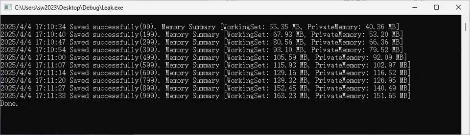

When operating on a large number of files using the SOLIDWORKS Document Manager API, I discovered a memory leak. The memory leak occurs at: Save(). How should this be addressed? Thanks!

                       if (swDoc.Save() != SwDmDocumentSaveError.swDmDocumentSaveErrorNone) // Potential memory leak!
                           Console.WriteLine("Failed to save!");
                       else
                           if (i % 100 == 0) Console.WriteLine();
                           Console.Write(\\\$"\\r{DateTime.Now} Saved successfully({i}). Memory Summary [WorkingSet: {workingSetMemoryMB:F2} MB, PrivateMemory: {privateMemoryMB:F2} MB]");
