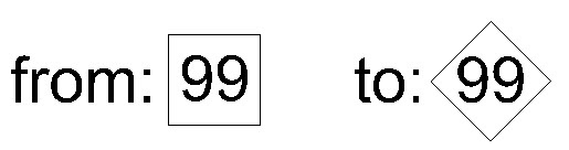

There is a file I would like to modify in the following directory:
C:\\Program Files\\SolidWorks Corp\\SolidWorks\\lang\\english\\Gtol.sym
I would to copy the follow section for modification:
Square Flag Notes Numbers (aka Flag Squ 1-99)
I want to modify the values defining the geometry as the square into a diamond shape for numbers 1-99. Question; has anyone done this, and can you post the values for me? See attached.
Example:
*1,Square 1
A,LINE 0.,-0.3,1.6,-0.3
A,LINE 1.6,-0.3,1.6,1.3
A,LINE 1.6,1.3,0.,1.3
A,LINE 0.,1.3,0.,-0.3
A,TEXT .8,.5,1
Please note: I know you can do this by adding a diamond boarder around the text and using character fit. I need to add this option to the “Add Symbol” under the “Note” function. My goal is to use this in our mechanical drawing notes.
