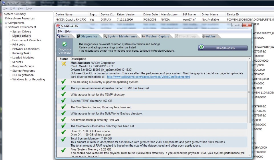

The enclosed part file repeats this error on my computer. I have a Dell T5400, Xeon 5420 processor, nVidia Quadro FX 1700 display card with approved driver for SW (7.15.11.6956), Vista 64 / 8Gb memory. If anyone with a similar system has time, please open my part and try editing the "Tab2" sketch as shown on the JPEG file. Let me know if you have any issues after selecting/deleting the perpendicular constraint in the graphics window. I've had a lot of grief between this computer and Solidworks, any help is greatly appreciated.
