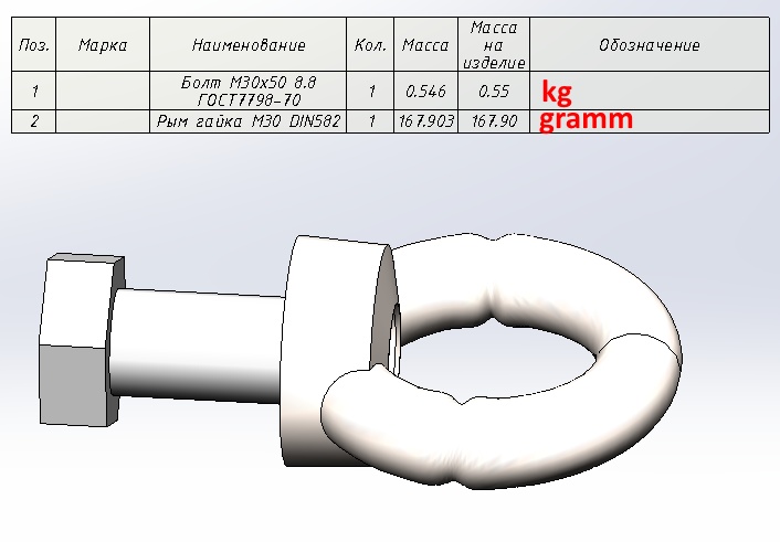

grams and kilograms in one BOM issue
SW makes me crazy one more time. Be careful.
Bolt file has kg unit for mass but the nut is in grams.
What I got in my BOM
SolidworksBill Of Materials
