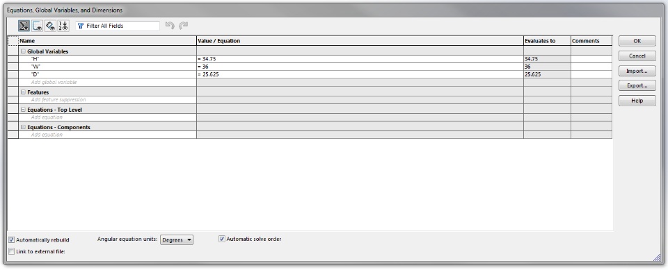

Here are the equations in my assembly, which is called 18163_SINK_CAB.SLDASM:

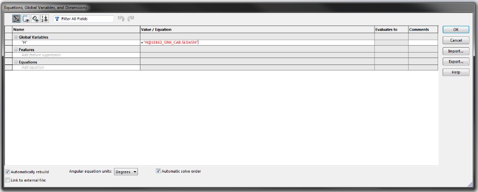

Now, here is the formula I'm attempting to use when I get the error:
The part and the assembly both live in the same folder on the server, and I even tried inserting the part into the assembly before trying to create the global variable. Same problem.
I know I can insert the part, then change the dimensions to reference the assembly's global variables, but that sometimes creates read/write issues when deleting or changing the part later, and it's too much of a headache.
Can anyone help with this? I remember doing it this way before, so it should work fine, but I can't find that old model to reference what's different.
