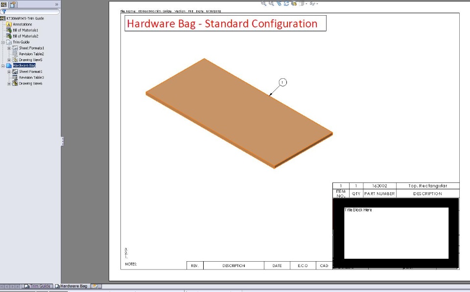

Given a "BomFeat" object, how do I determine what drawing sheet it is on?
In my attached example, I have two drawing sheets each with a BOM.  I want to program a macro to delete only the BOM on the second drawing sheet.  I already know how to select a BOM and delete it, but no idea how to know which drawing sheet it is referenced to.
Is there a method I can use to determine which BomFeat is on the second drawing sheet?
