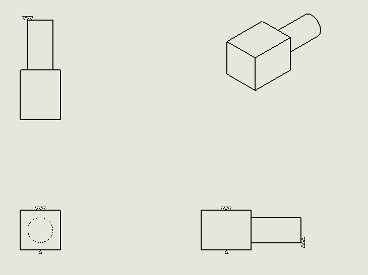

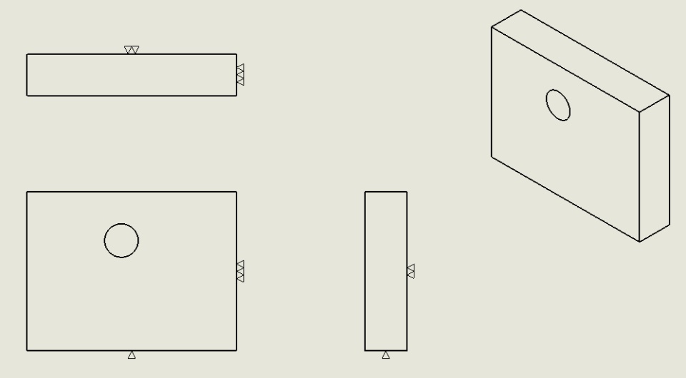

I'm working on a SW2012 VBA macro for inserting machine marks on prints automatically. In our current workflow, the designers color machined surfaces white in the Parts. I modified our face colorizing macro so that an attribute is added to the Face. When the active document is a drawing, the macro traverses all views, deduces which visible edges are bounding a face that has been marked for machining, and excludes faces that aren't perpendicular to the view's "camera axis", and inserts the appropriate nabla symbol.
Thus far, it works fine for simple planar faces but curved faces are causing trouble.
I believe I've narrowed it down to the following call.
vVisibleEntities = swView.GetVisibleEntities(vVisibleComponents(0), swViewEntityType_e.swViewEntityType_SilhouetteEdge)

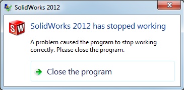

When the macro executes, I observe the silhouette edges being selected in rapid succession and then it crashes.
There are no explicit calls to select any silhouette edges in this macro. When the above line is commented out, the macro performs as usual but does not consider the silhouette edges of that cylindrical surface depicted above.
Has anyone encountered this before with silhouette edges on drawings? This is an annoying thing to troubleshoot as my VBA editor has to close every time I get it wrong.
