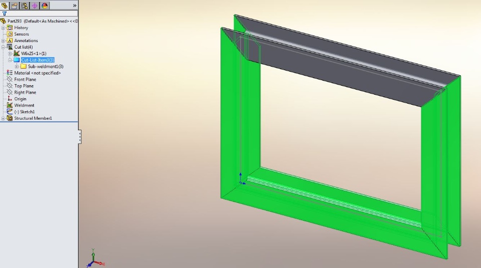

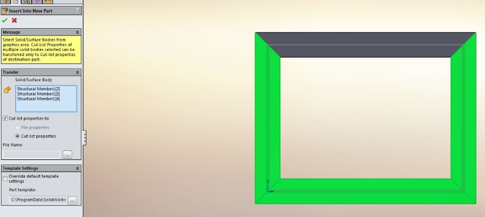

Hello All,

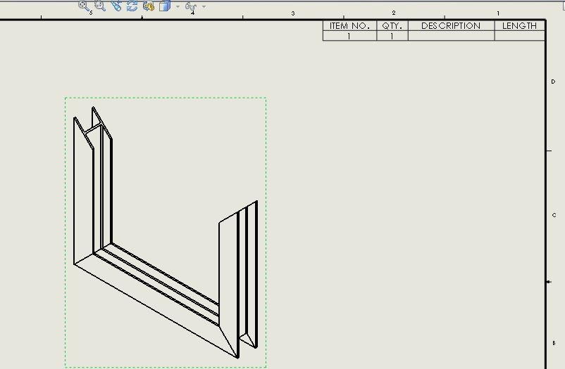

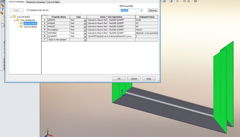

I have been reading on this for about an hour and cannot figure out why a sub-weldment from my main weldment will not show the cut list items in a table.  Basically, once I created the sub-weldment, I right-clicked and chose "insert into new part".  Then once I saved the new part, I created a new drawing, brought the sub-weldment iso in, then selected it and insert a weldment cut list table.  It shows nothing.  I did check the box for cut list properties (see pic below).  What am I doing wrong?  This can't be that difficult.  As far as I can tell, all the cut list item properties are transferred, but the table shows blank.  Appreciate any feedback.  Thanks!
