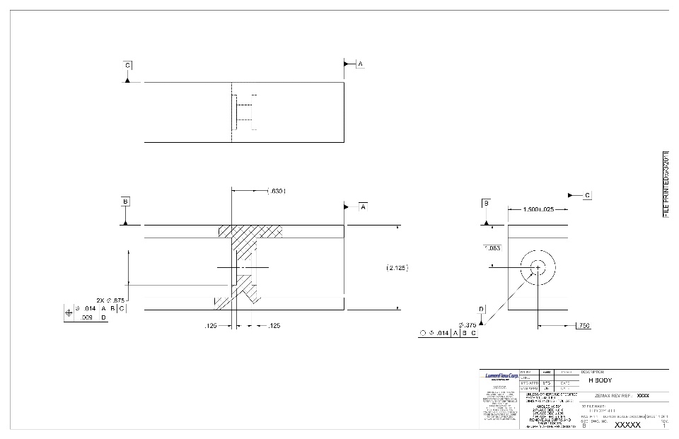

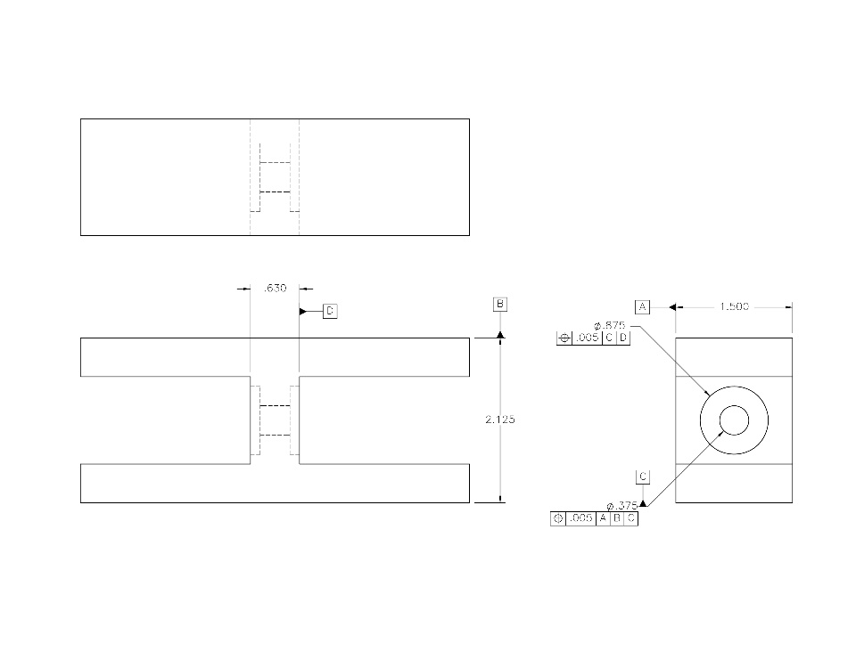

i would like to get your suggestions for gdt dimensioning this part. the part is an aluminum extrusion, we just put the hole and spotface on it. i have a pretty good idea of how it should be done. id like to see how you guys  would do it
