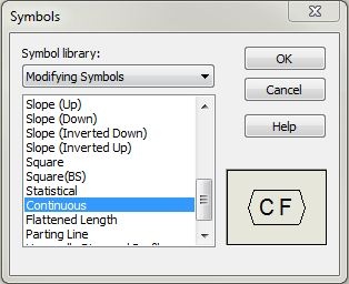

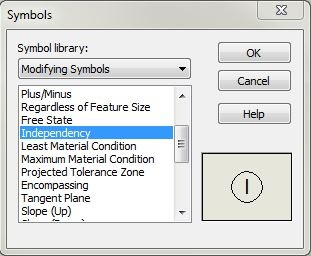

This question was send to me by one of our group members and I don't know the answer:
I am still using SolidWorks 2011.  Do you know if 2012 has the new symbols that were added to the Y14.5 Standard?  Like, circle I for in dependency, CF in a hex for continuous feature, the translation modifier which is like a delta on its side.
