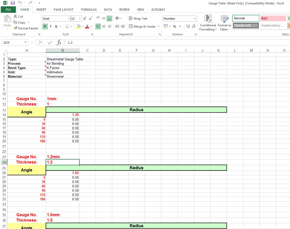

I have recently started using a simple gauge table, at the moment it is largely to "force" me to use the "correct" bend radius for a given thickness without having to look it up, and to lock my K-factor at 0.5. This might not be exactly correct, but it is early days.

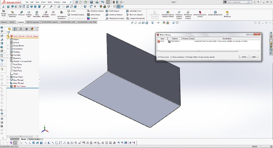

Anyway, the gauge table seems to work well, until I go to generate a DXF, or flatten the part. At which point I get the error "Could not find the bend table. Please select another or specify a k-factor." This seems odd to me as I am using a gauge table not a bend table. My gauge table does include values from 0° to 180°.

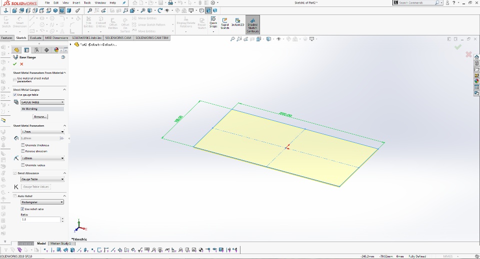

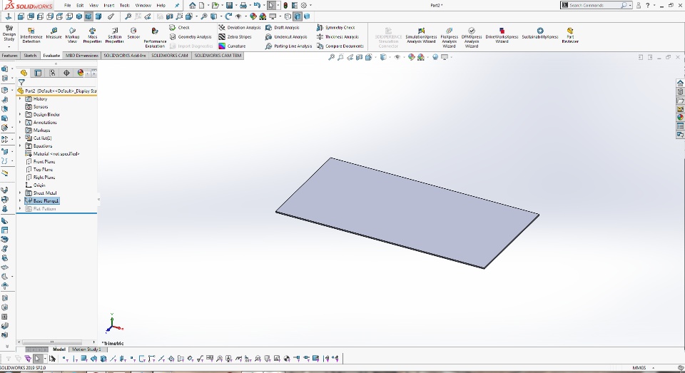

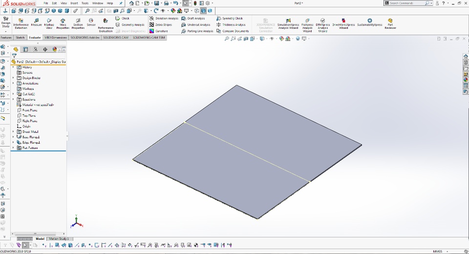

Creating a base flange using the gauge table.
Works fine.

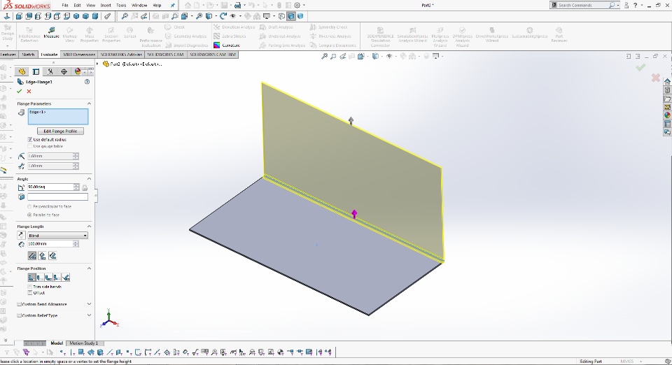

Adding an edge flange
Also works fine.
Click flatten, and I get this error.

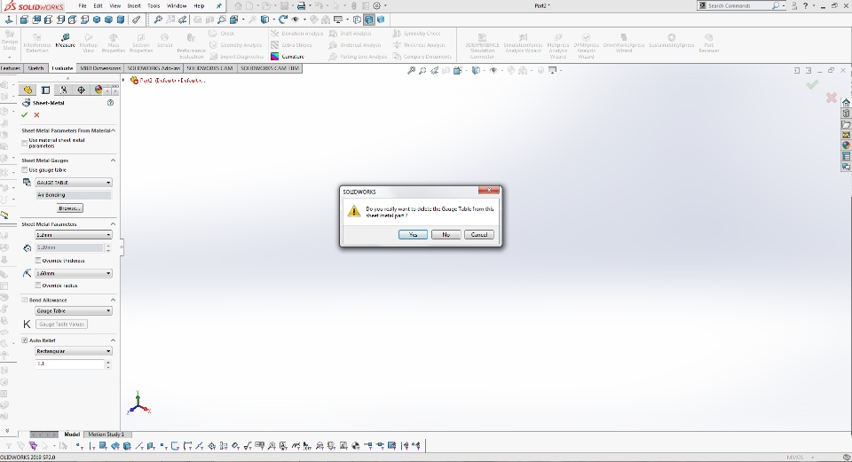

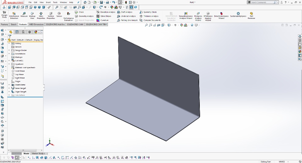

Deleting gauge table and leaving the thickness and radius the same.
Part flattens fine.
