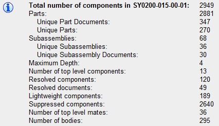

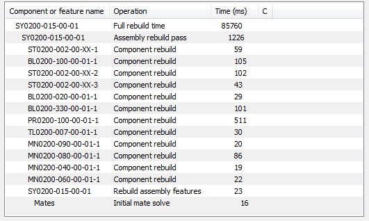

1. I did an AssemblyXpert analysis on one of our assemblies, and these are the results:
Clearly the only issue in this simplified assembly is the full rebuild time My question is what is taking all this time?
2. If I have my simplified configuration with mostly suppresed components and mates, is that just as fast as deleting them? or do all these suppressed componenets still provide loading time?
3. Many subassemblies are not loading lightweight. Why is this?
