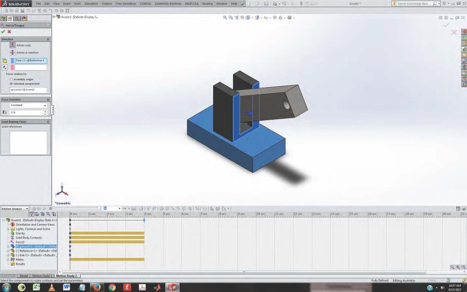

Hello, my problem is very simple...i have a block which i have to move over ground by pulling or pushing horizontally..attaching the screenshot of the simulation problem...u can see in the screenshot (file name: capture) force is  applied and gravity is also applied in the model...now if as i used 3d contact force so friction and contact force comes into the picture..Now i  m providing  you below mentioned theory and equations
my target of project is to calculate this friction and contact force (IMPACT) manually in order to verify and generalize other problem. But, from the expression of the impact function the value of expressions of x,x',x1 are unknown and remaining all parameters are given for a given pair of contact.
Question: so can anyone provide me the value of expression of these three parameters such that i can calculate the impact force?
