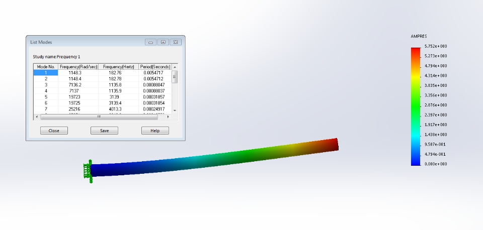

Hi I was using solid works for frequency analysis, a cylindrical beam with area 78.5 sq mm and length 200mm fixed at one end. the results show two close natural frequencies, I am pretty sure that it is not true because the same model in matlab is yielding no close results. They are quite distinct
Frequency(Hertz)
in solid works                              in matlab
182.76                                            182.5
182.78                                             1135
1135.8                                             3139
1135.9
3139
3139.4
how should I understand the results from solid works? can any one please explain.
