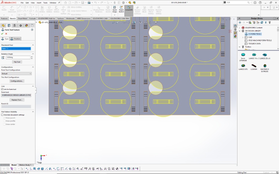

When I try to put form tools on a sheet metal part which have the stopping faces overlapping with existing form tools I get a rebuild error because the form tool is overlapping with another form tool (lets just ignore how stupid this is for now). To get it to work I have to increase the spacing so the stopping faces are not overlapping, apply the feature, go back into the sketch which defines the tool hits, decrease the spacing to what I actually want and exit the sketch again. After doing this I have no rebuild errors, even though the stopping faces are now overlapping which caused an error previously.
Is there a way around this? I'm sick of having to do this work around.
