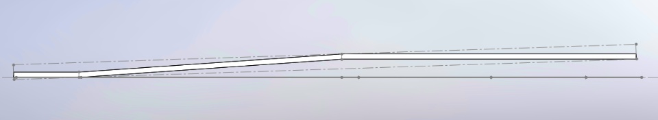

We use flat bars and plates to create custom H-Beams that represent the beam of our trailers. Generally, the beams are straight so it's no problem to do this. Sometimes, there's a kick into it and that's what complicates things a bit. The kick isn't all that complicated, it is what the shop asks of me to do. Here is a picture of the final result:

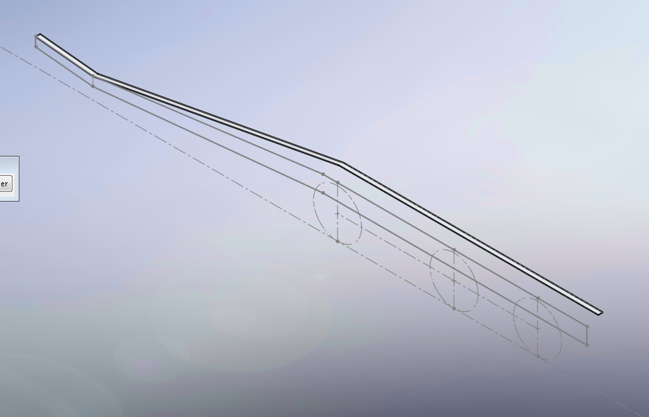

What it looks like in iso views on paint:
So right now, what we do is this. We build the flatbar as a plate and have it be cut from a flat pattern that generates way too much loss of material.

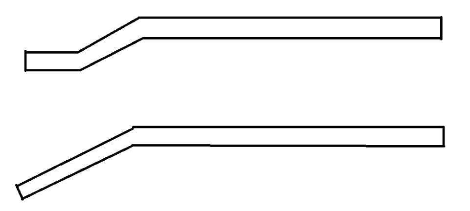

What my boss would like to be able to do, since it is do-able on the shop's floor level, is to be able to do a bend not only in the thickness but also a bend in the width, so that the flat pattern would actually represent a rectangular shape(approximately) instead of the huge flat pattern I have posted above. This would allow us to consume them as flat-bars and reduce our costs.
Any takes on this?
