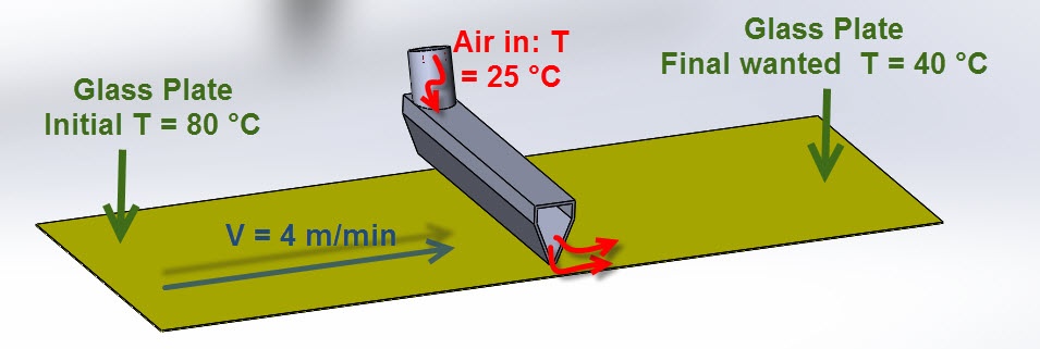

Hi, I would like to create a study to determine cooling of a glass plate.
The study in described by this picture:
- a glass plate has an initial temperature of 80 °C
- the plate moves with a 4 m/min translational velocity
- a fan pushes air torwards the plate. The air being pushed has a 25 °C temperature
My aim is determining the air flow rate to put in order to have the plate cooled to 40 °C.
I'm not modeling the fan, I'm using an inlet flow rate of air.
