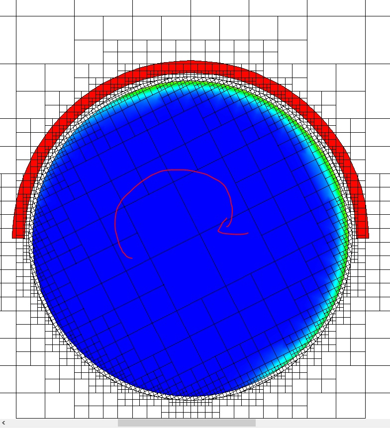

I am try to simulate a rotating cylinder the is being heated by an electric heater covering half of the cylinder.  I've tried the averaging mesh and sliding meshing with the rotating body but neither seem to work.  The mesh appears to move in the flow simulation tracking window but only one side of the cylinder gets hot.  Any suggestions?  Is solidworks able to do this?
