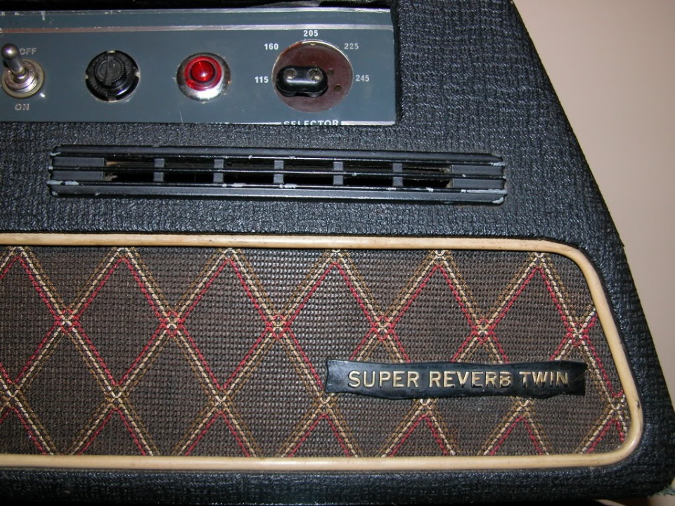

PS Here is a partially completed model of the amp. Only 3 filter caps shown so far. Most of the other caps are on the turret board and actually soldered above a resistor
Note heat marks on chassis
Note small vent slits on front and back of amp head
There is no hole behind the cloth. Air can only enter via the thin slit vents
