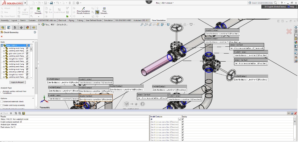

In the midst of modelling a pipe routing for simulation, I have encountered some issue.
In the screenshot, the status is shown to be "failed. Non watertight model" with quite a number of "zero-thickness curve/line invalid contacts". Upon checking, realize the errors occur at the neck flange connections.
Are these "zero-thickness curve/line invalid contacts" the leaks?

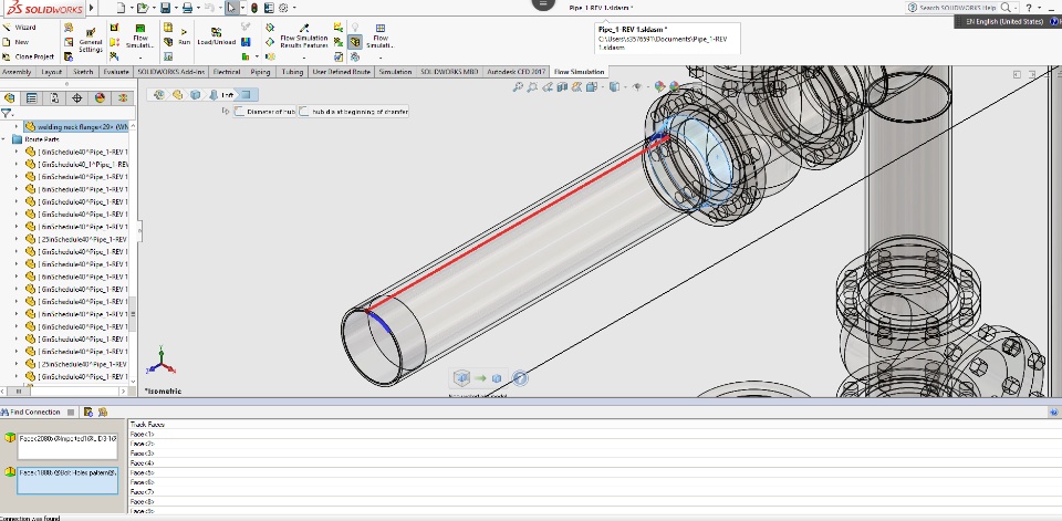

While using leak tracker, the screenshot below shows the leak, but I am not able to resolve the leak.
Hoping some kind soul can enlighten me on if my understanding is right and how the leaks can be resolved.
