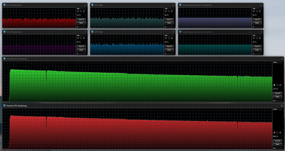

I’m running out of ideas, and this problem has existed for about a year now. I can’t run long-term time-dependent simulations because after each timestep I am farther from the solution in terms of compute time than before. In some cases, the time per iteration increases by a factor of 7–8 within 24 hours. Here you have screenshot with logging over close to 6 hours for the big charts, the small ones arround 2 hours shown.
(Top to bottem, left to right)
- Core-Temperture CPU0
- CPU-Temperature CPU0
- Cache-Temperature CPU0
- Core-Temperture CPU1
- CPU-Temperature CPU1
- Cache-Temperature CPU1
- CPU-Usage CPU0
- CPU-Usage CPU1
