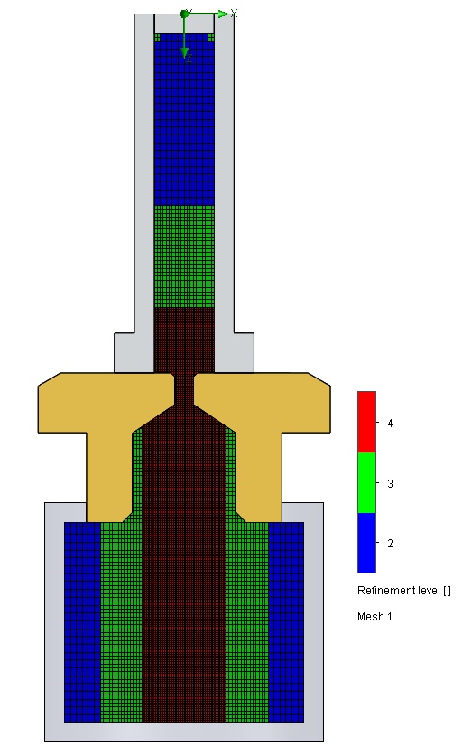

This is the mesh setup we used:

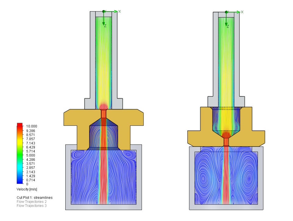

Here we have the velocity plot after 100 iterations (the flowrate converges by the 60th iteration), for both cases of flow (inverted and normal) with hole diameter of 0.92mm.

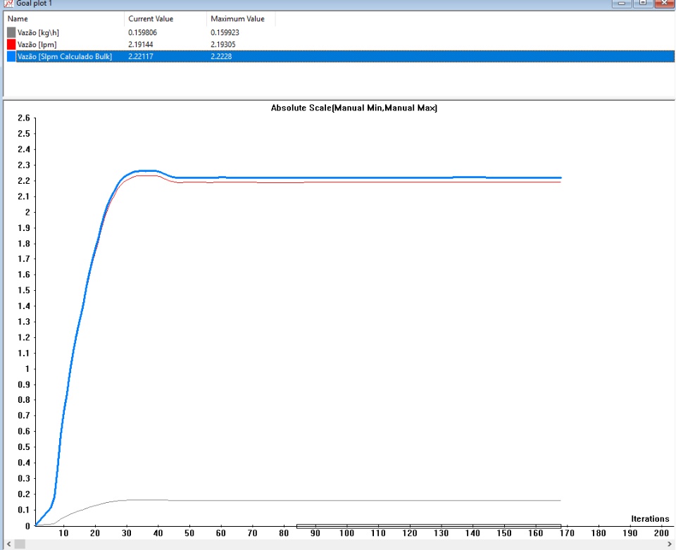

This is the Goal Plot during calculation

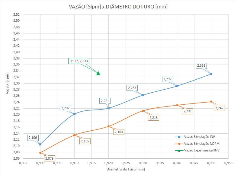

Here is a graphic with all our results, the blue line is derived from the simulations results with flow in the oposite direction (like our experimental setup), the orange lines is derived from the simulation results with normal direction flow (like our client setup). The green triangle is our experimental result derived from the average of 13 measurements.
The simulations results for flowrate are about 5.2% lower than experimental. We have changed several parametes, like roughness, meshing, pressure, and even simulated with the exact experimental conditions, but the numerical resultas are aways lower in the order of 5%.
