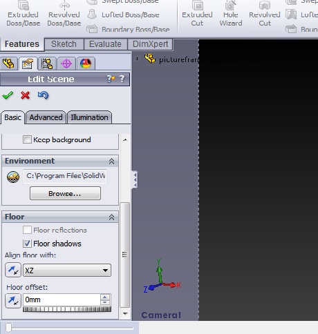

But that's a rant for another time, right now I'm wondering why Photoview will not render floor reflections? I could render them fine in PW last year but now I find when I try to edit scene (even with floor shadows turned on) the tick-box for Floor Reflections remains un-available:
I'm aware this could be a graphics card issue, but I can't find anything online about it yet. I've tried rendering preview window and through a camera. It's not really very useful for me to have a reflective floor scene that doesn't reflect anything when I render it.

PS - I've tried going to turn on Realview Graphics and I find the option un-available, so I am assuming I could be leaning towards the Graphics Card problem?
