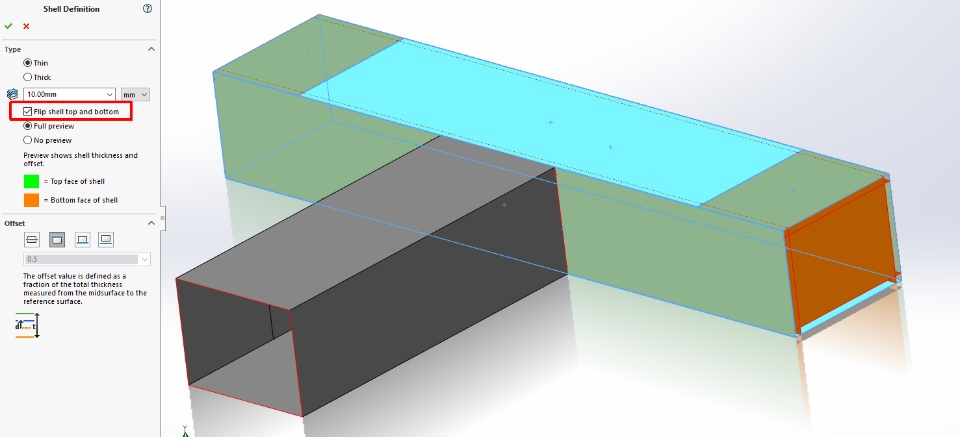

when defining shells in a static study, I will use the Flip shell top and bottom option to correctly align my shells. If I make any change to model, then return to the study tab and remesh the Flip shell top and bottom tick is unticked and it will cause havoc with my shell directions throughout my model.

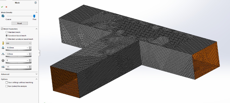

Creat mesh with the following parameters
change a dimension in the model, rebuild and remesh.

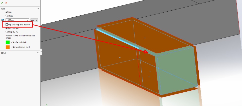

the flip shell top and bottom tick will be deselected and needs to be redefined.
this can cause havoc in a study of a large assembly with a lot of shell bodies.
