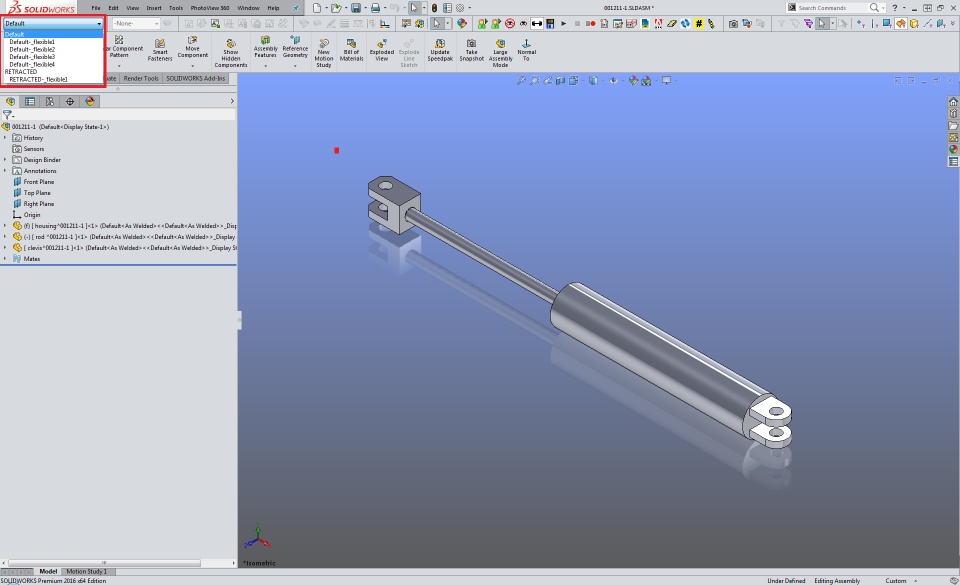

I use flexible sub-assemblies with multiple configurations to represent various motion positions.  Very often, when I open the top level assembly the constraints will be broken.  If I edit the flexible sub-assembly in-place, and conduct a rebuild, the broken constraints will be repaired.
Additionally, I use configurations for parts, but the configurations often switch away from the one intended within an assembly.
These two issues have increased dramatically since I installed SW2015.  I do have work arounds, but I am spending ever increasing amounts of time repairing broken constraints as the designs become larger and more complex.
