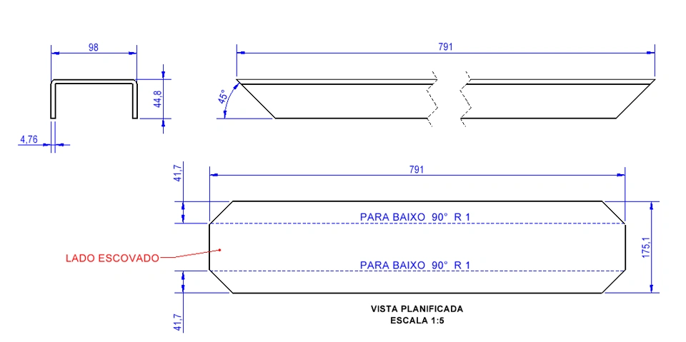

Does anyone else have the same problem when opening a drawing (.slddrw) that contains a flat pattern view of sheet metal?
I create the drawing normally, save it, check it into PDM, and everything looks fine.
However, when I need to reopen the drawing, the view that was showing the sheet metal in the flat pattern goes back to the folded state, causing the dimension references to be lost.
I have to select the view, check and uncheck the “Flat Pattern” option, close the drawing, and reopen it. Only then does the view load correctly.
